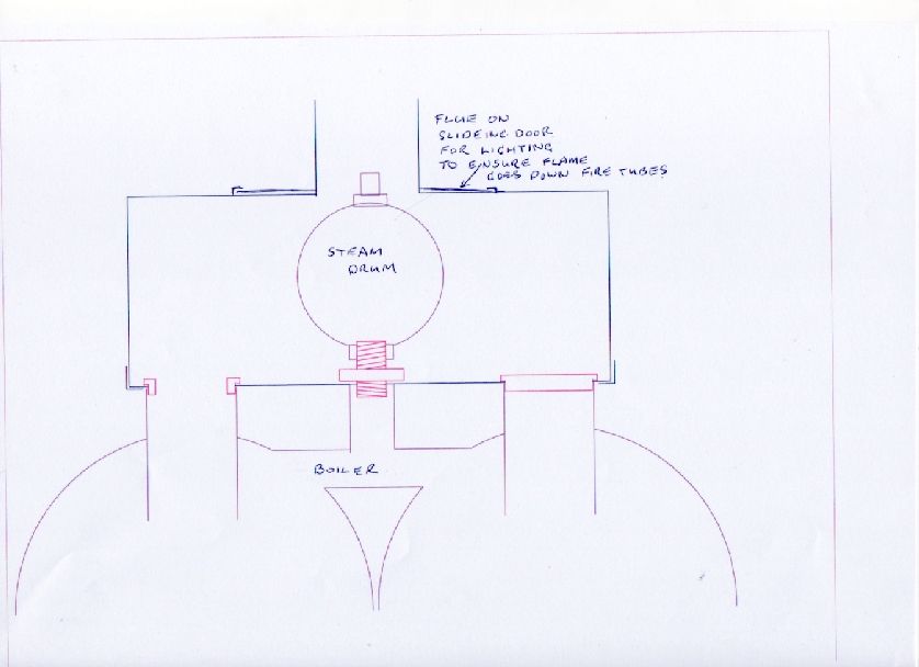

At last some progress, the main part of the boiler all soldered up. The steam drum scraped and an new design will be made. When complete it will be joined to the top of the boiler by a special fitting, a right hand thread on one end and a left on the other.
This will solve a problem I have been pondering for quite a time, how to make the flue manifold gas tight. The bottom plate of the manifold fitting on to the three bushes, one steam (to the steam drum) two flue. After the drum is fixed the rest of the manifold bolted to the plate.

« Reply #476 on: May 14, 2012, 10:01:22 PM »
The drawings for the steam drum and manifold. Hope you approve Derek.  :beer
As for boiler inspectors, the trouble I have is finding one. They only like TRAINS.  :offtopic Geoff
