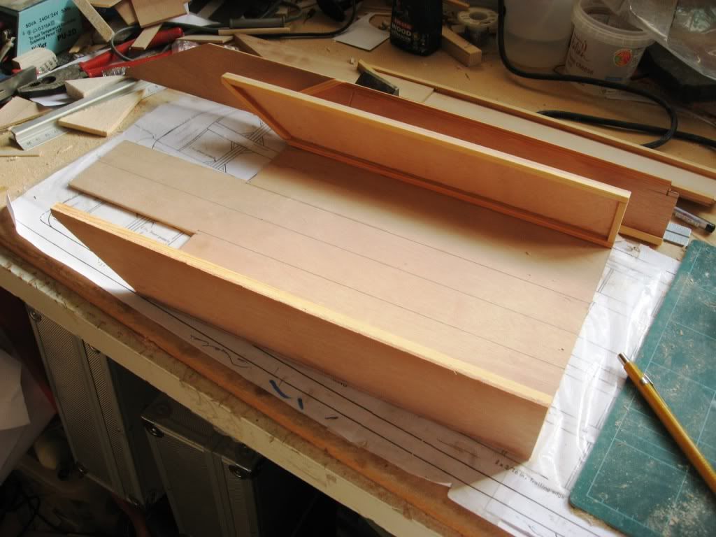

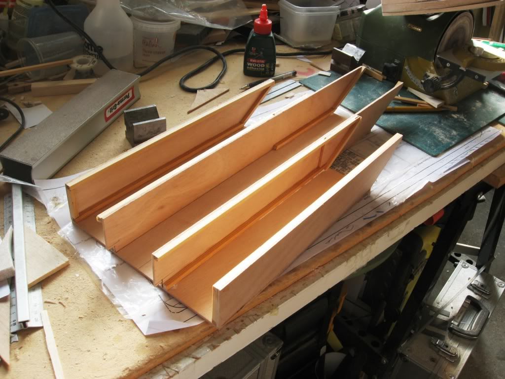

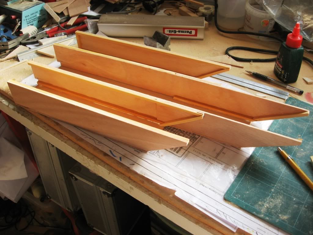

I have made some progress on the Lulonga, there's a bit of work in the hull to accomodate the paddles, which so far has been quite enjoyable.
The bottom, sides and the lower deck are cut out and I am starting to get it all glued together. If I have got it right there should be some photos. When I have got the hull built I will be able to make sure the other parts fit as I cut them out.

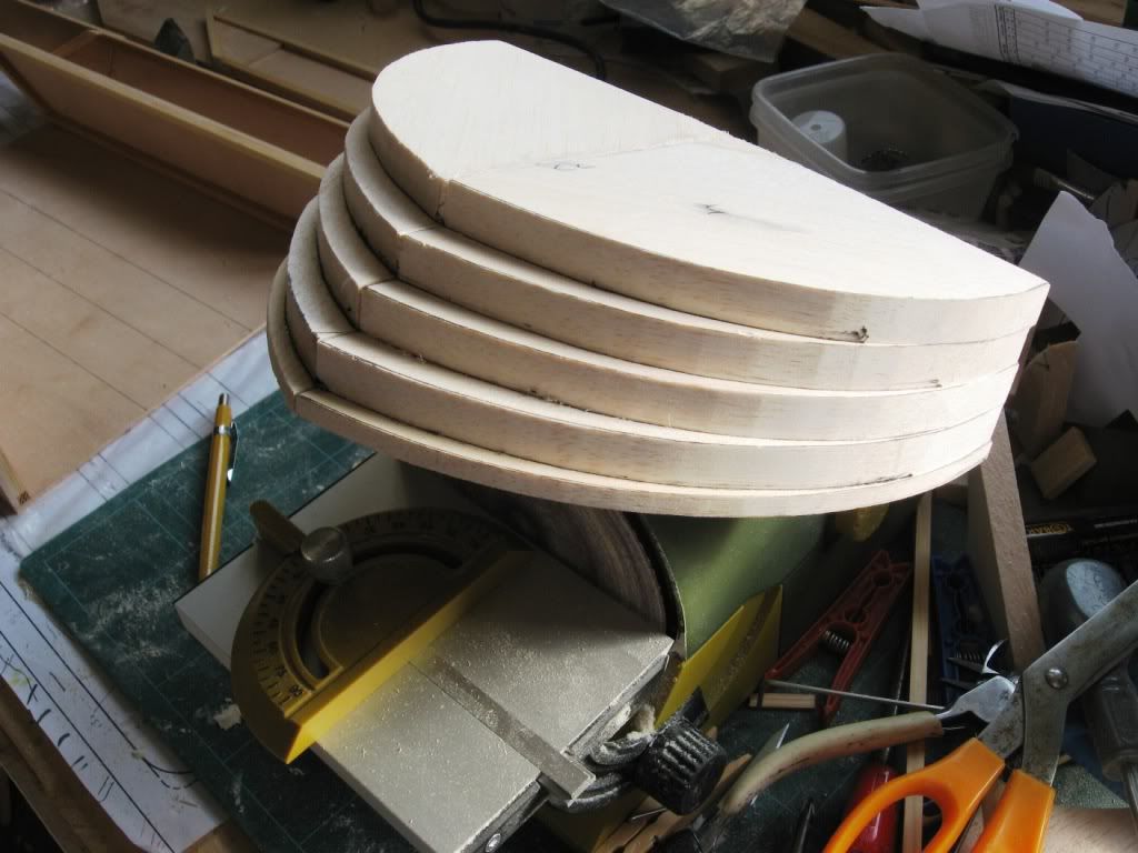

I have laminated the bow section from balsa, it just needs carving to shape.
More to come...
Bert

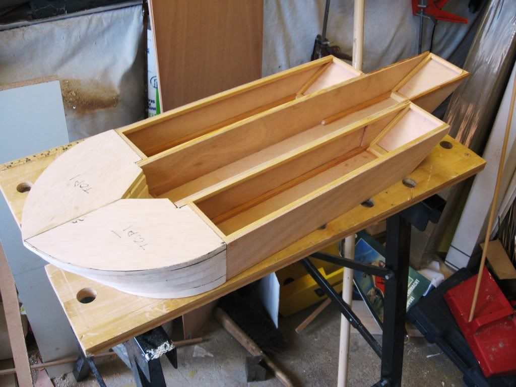

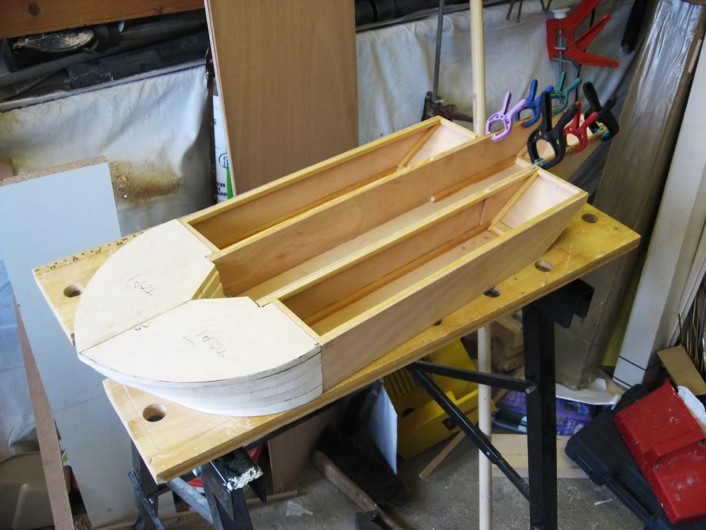

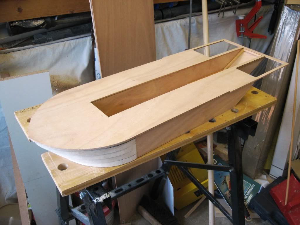

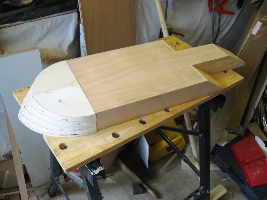

I've made some more progress, I shall shape the basic hull first and then fit the bow section and shape that last, hopefully this will avoid damaging the balsa bow laminations. When the hull is complete I intend to skin it with lightweight glass cloth. This will make it watertight and should make it more resistant to knocks.
Trial fit of the bow section.
Bottoms up
Trial fit of the lower deck.
More to come.
Bert

August 13, 2012, 01:53:40 AM »
Hi Bert, Before you fit the deck I would fill the side pods with Polystyrene or Polyurethane foam, hope that they are spelt correctly, as I had a big problem with mine in all but the smoothest of water conditions taking on water into these chambers, and on one sail it nearly rolled over. I hope that you don't mind me saying this as I would hate you to find out after you have added the deck. The model is progressing very well, and makes me wish mine was on a wooden hull not a Poly carbonate one. Cheers Graham

Thanks for the advice Graham, I think I will put some foam in the compartments, though it is my intention that they will be completely sealed which is probably easier to do with a wooden hull than a plastic one.
Bert
