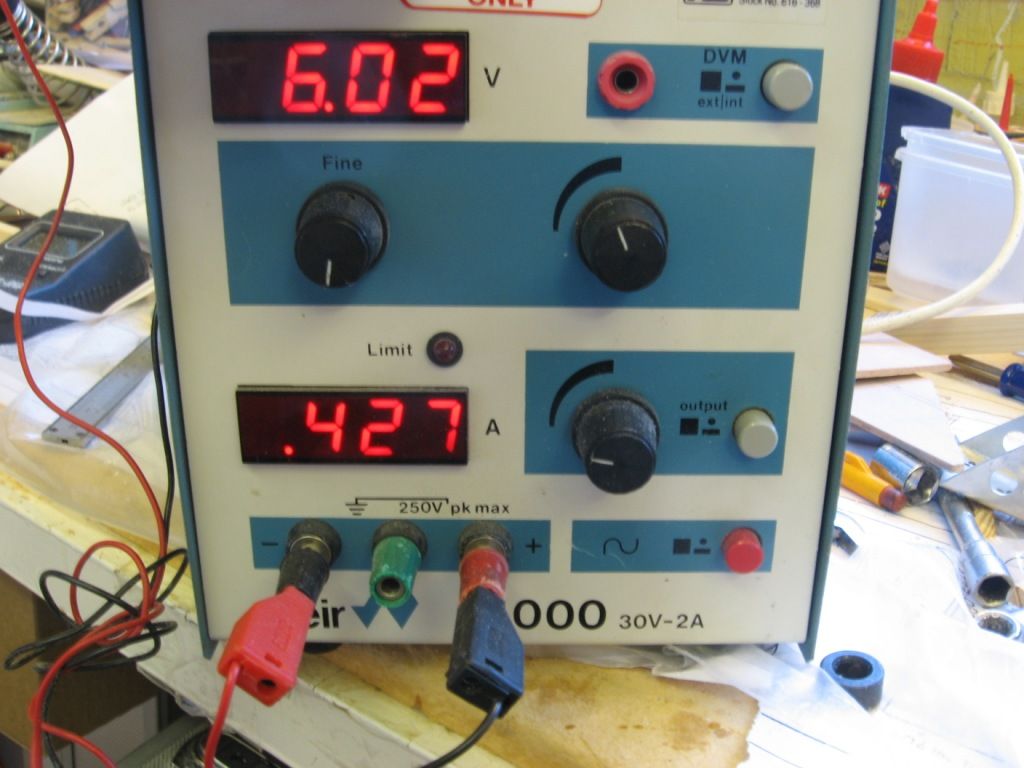

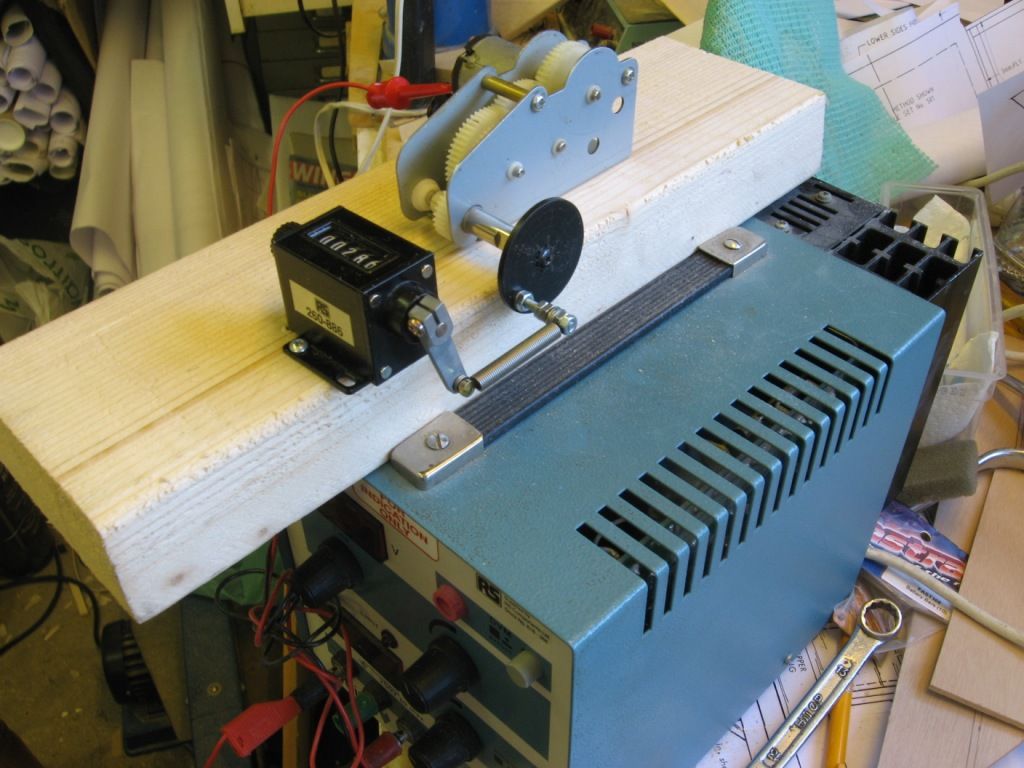

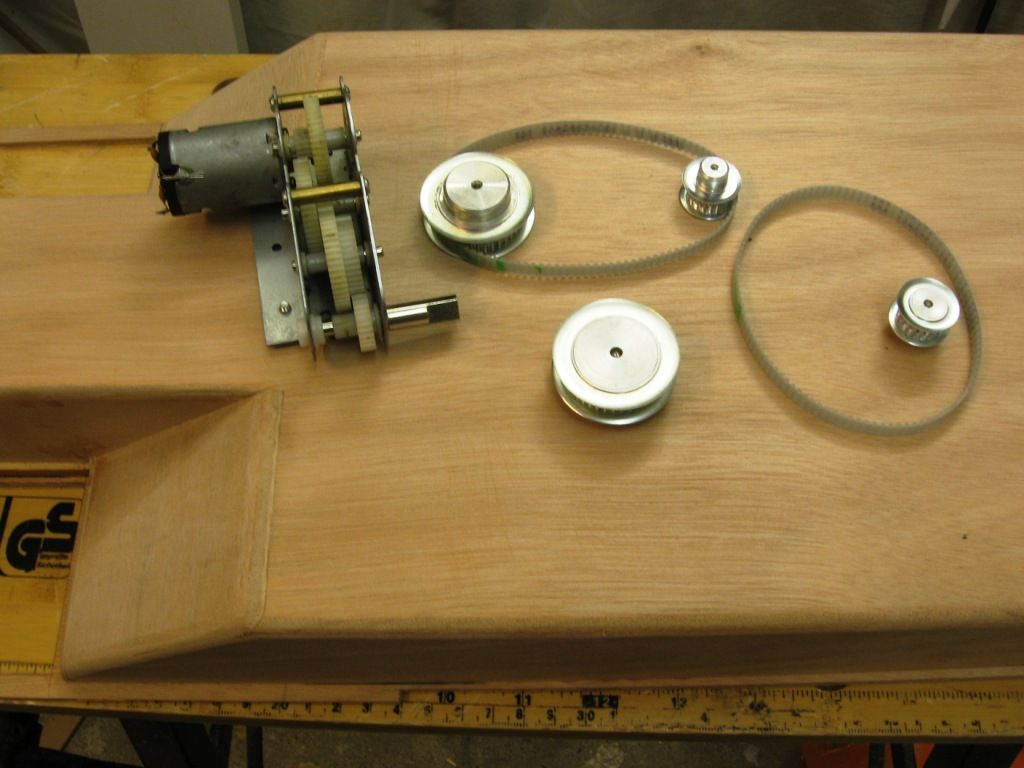

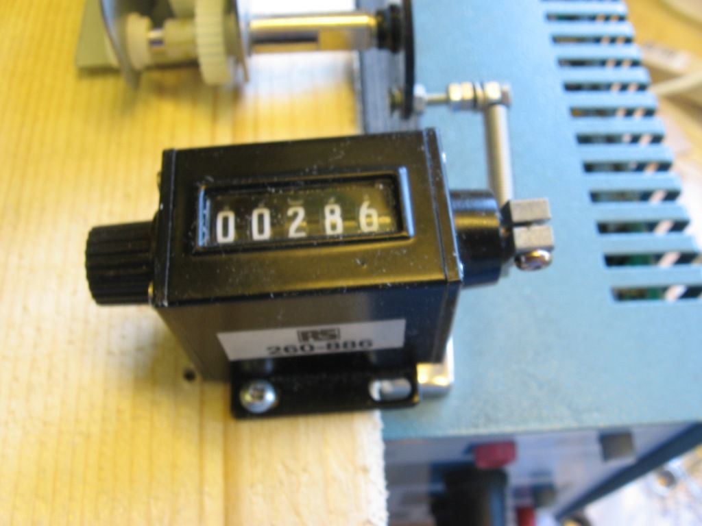

I had to do some proper measurements to check the actual speed and current draw at six volts. The test set up all a bit crude but I'm now satisfied that it will do the job. The speed at six volts is 286 RPM (measured) and the current draw tallies with what I roughly measured when the drives arrived. I will sort out a final drive of 2:1 to the paddles to get around 140 RPM.

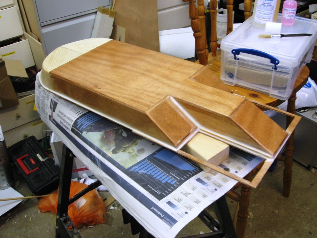

I glued the lower deck in place last night and did some measuring up for the final drive to the paddles (for when I get them made).
I plan to use aluminium timing pulleys 2:1 to get the final speed about right. I have ordered these (40t and 20T):
http://www.technobotsonline.com/pulleys-and-cams/aluminium-timing-pulleys/synchroflex-t2.5x6mm.html
I hope my measurements are right, they came to £27 including postage which is a bit more than I wanted to pay but I couldn't find anything cheaper. I could have gone for ordinary pulleys and belts but I want to avoid any chance of them coming off.

The drive stuff has arrived from Technobots and it seems that my sums were correct so that's a relief. I shall have to remove the output shaft from the gearbox and turn it down a bit. I don't know what metal it is but I can mark it with a file so I guess it will turn ok. The shaft is 8mm diameter and it needs to be 5 or 6mm to avoid having to drill too much out of the pulley.

Hi Bert,
i would say that it should turn no problem if you can score it. those belts and pullies look like they should work a treat
Ian

Hello Bert,
Drive chain looks good, will you do mock up before installing , ?...
cheers Larry..

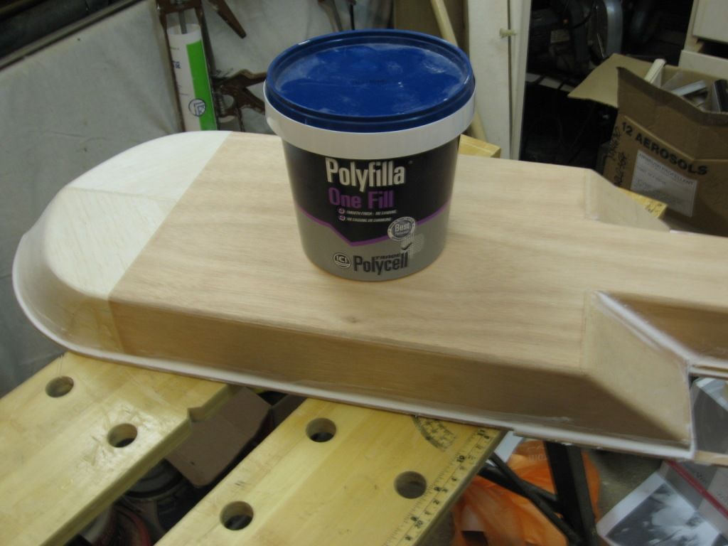

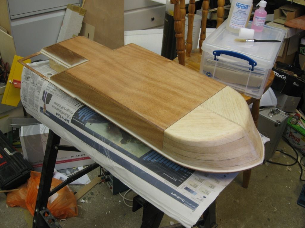

I got back on with it today, not too much progress. I filled the joint between the lower deck and the hull.
When it's dried off I shall sand it and start glassing. I use this filler, it's very easy to sand and doesn't shrink. It's also incredibly light which makes it good for aeroplanes too.
Bert

I have glassed the hull, I have to wait until it cures so I can flat it down and give it the second coat of resin.
Bert

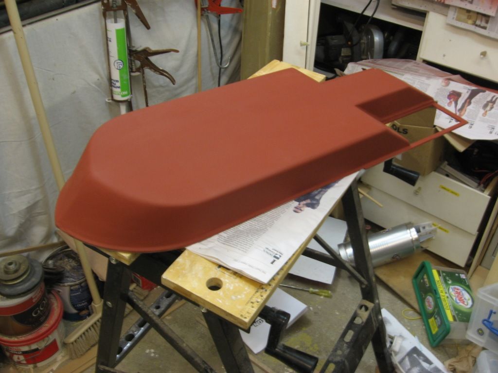

After much elbow grease with the 400 wet and dry the hull got a coat of Halfords spray can red primer. They do two kinds, one for plastic and glass fibre and another for metal and previously painted surfaces. I went for the former and it seems to have adhered well. My only misgivings are concerning the likelyhood of the matt surface picking up shiny marks. I may overspray it with some kind of clear laquer.

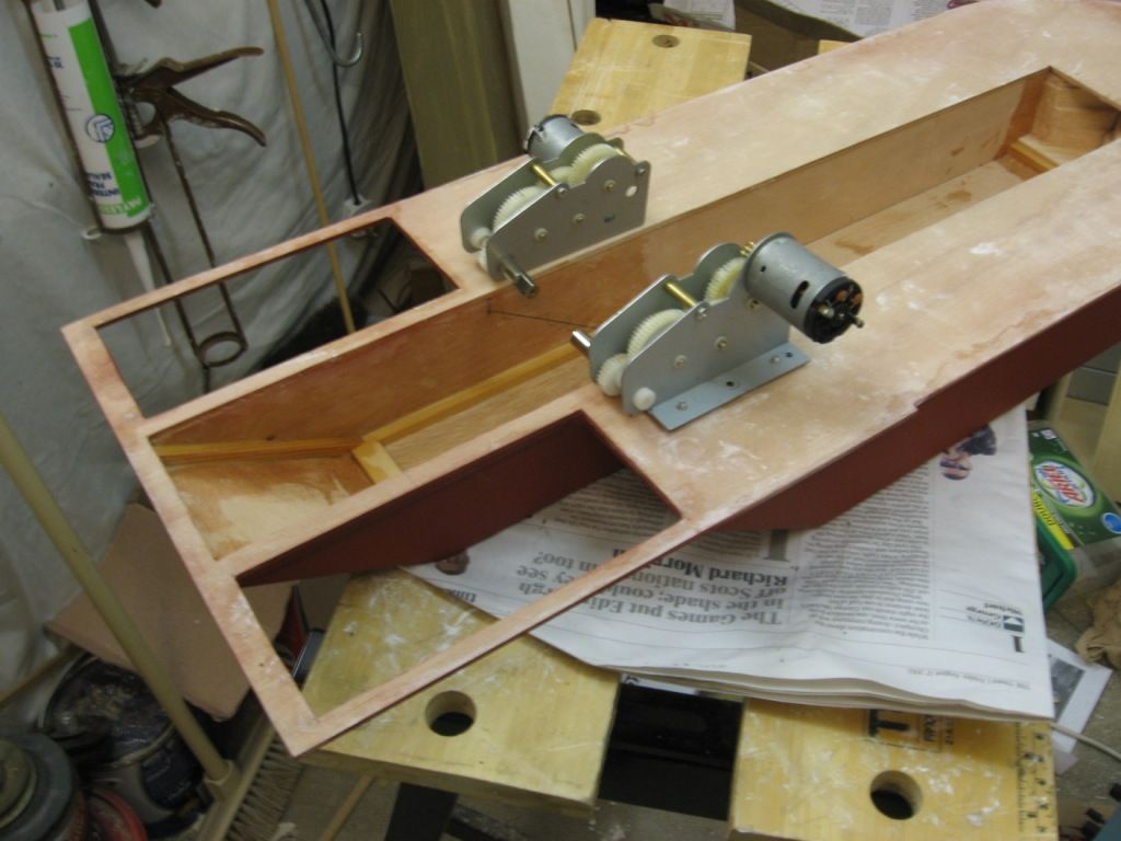

I shall now turn my attention to the paddles and drive system. the plan (if that word can be used for my haphazard meanderings) is to completely enclose the gear drives and to insulate the mountings so that there is as little sounding board effect as possible. I don't want my paddle tug clanking and whirring like a Sherman tank.
There is plenty of room for the motor/gear assemblies so that's good.
Bert
