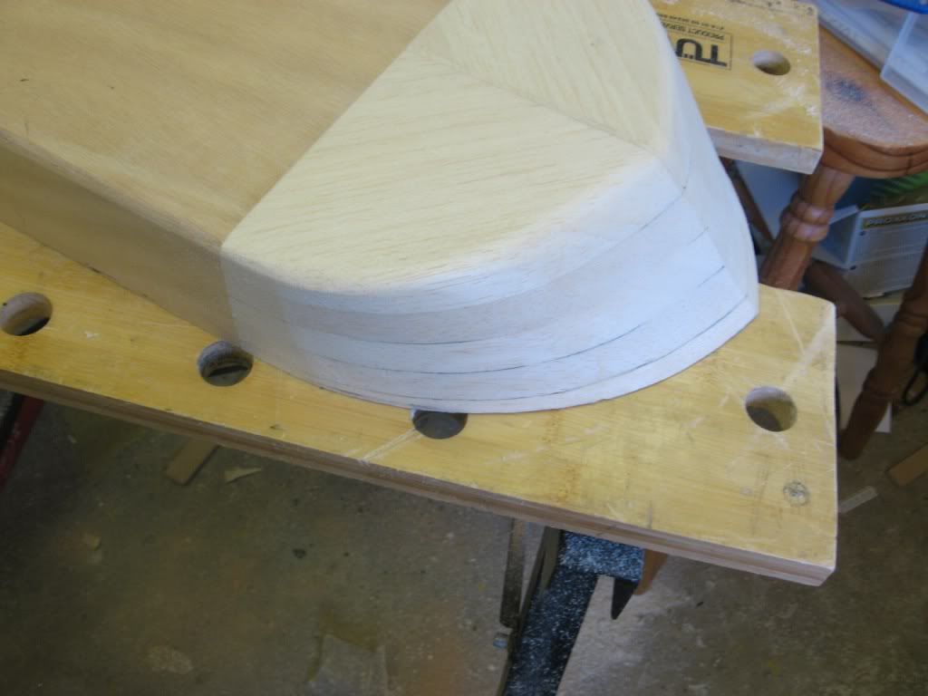

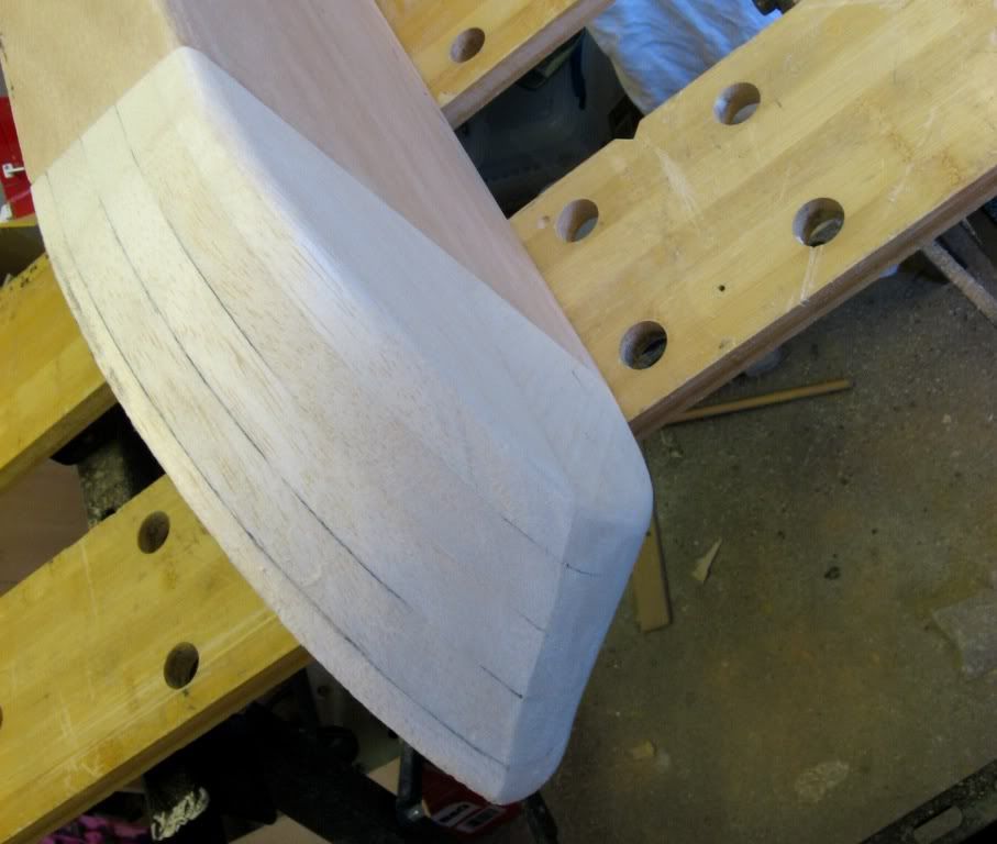

I did some sanding on the bow laminations tonight, it's roughed out. I will finish sand it tomorrow if I get some time.
More to come

LARRY W
Re: Lulonga - My first paddler build.
Reply #20 on:
August 15, 2012, 05:11:36 AM »
BERT ;
Looks good , you will have bulwarks coming up from deck level ,
cut card templates at this stage to get the idea of bow flare , also there is a rubbing strake at deck level ,
cheers Larry...

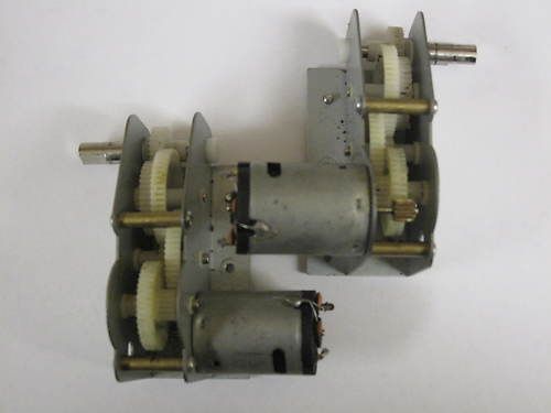

15Bert
Reply #24 on:
September 05, 2012, 08:30:41 PM »
After a bit of thought (not much!) I have gone for a second-hand set of 1:16 tank drive motors and gears from the 'bay.
They look like they may fit, and hopefully will be around the right speed and power. At about five quid including postage it won't break the bank if it's no good.
Hopefully they will turn up in the next couple of days so I can get on with it.
Bert

September 07, 2012, 11:58:01 PM »
The tank drives turned up today and they look pretty good to me.
It's difficult to measure the speed with my aeroplane tacho, but at six volts it looks to be about 200rpm, I can gear it down a bit through the chain or belt drive to the paddles so I think it's going to be ok.
The current draw at six volts is less than half an amp even when loading it up by trying to stop the rotation with my fingers so no problems there either. I can't stop it or even slow it down significantly with my fingers so the power should be enough. It does sound a bit puny at three watts per paddle though. I'm more used to 350W and more with my model aircraft but I guess that's a totally different scenario.
They are a little noisy but if I mount them on rubber I think they will be quiet enough, time will tell I guess.
Bert

Hi PD's......Bert with that low current draw [two x 0.5 amp unloaded] ...an inexpensive ESC capable of handling say 5 amps will certainly suffice
You are correct that seemingly lower input power at geared down speeds can produce HUGE torque values that would break a finger so ......
...so best left at that ....Derek
