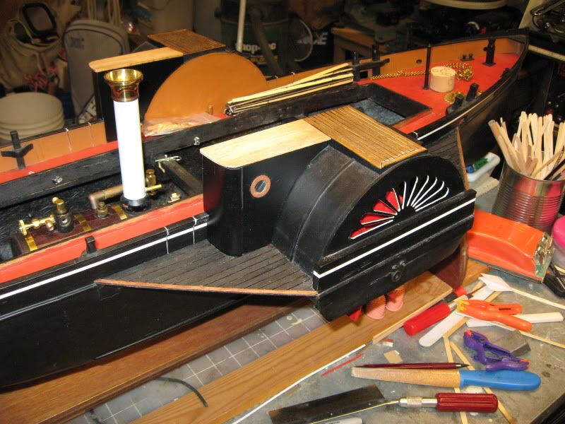

I have done the planking on the starboard sponson decks ( if that is what they are called?) portholes and roofs on the newly added galley and WC areas. Now to plank the Port side

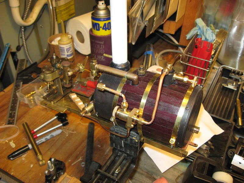

the last shot shows the condenser nestled in place under the RC bits tray
No the stack will not have a brass cap-- :-[ I forgot I had it up there
As soon as the attenuator arrives from Phil at Forest Classics- plumbing commences!!
I believe I may stray from the true Clyde color scheme and go with white half way up the sponsons- just so they stand out more on the pond- at least that is how I am feeling today..

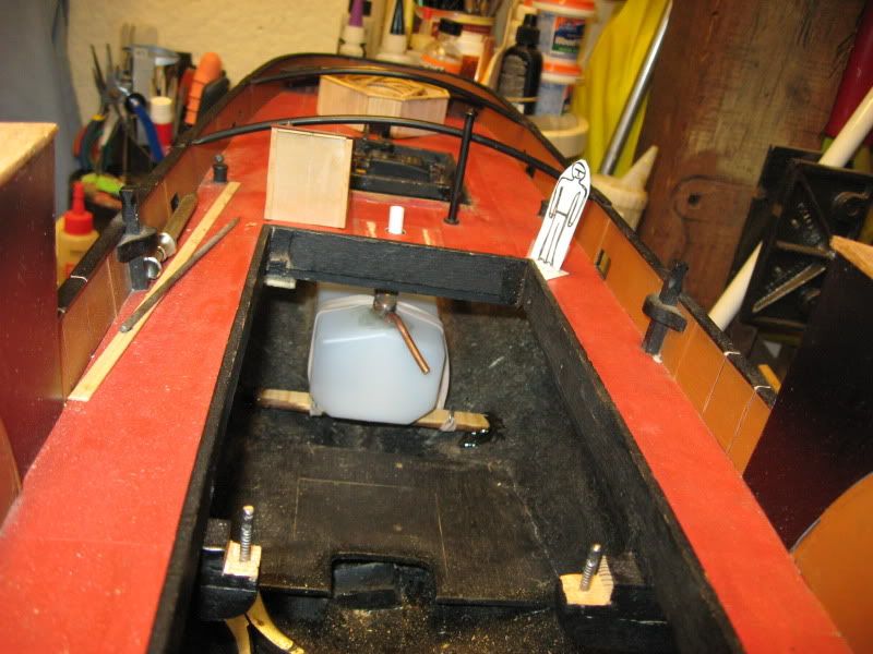

As The wait for the final plumbing parts drags on - more deck details attended to - rear steps up the paddle boxes, piping aft or the stack ( made from spend 22 casings and thick solder bent into shape!)the foredeck skylight made and new mast placement drilled and fitted and a few other small things done. Also made the tow hook functional after affixing it and making the hook spring centering. A rear bowser line will help keep any tow line and  job centered and directing the leverage down on the wheels- if I do any real tow activities..we will see with careful testing.
Taking it all apart and painting will commence in a short while- I think I will never really be the Flying Scotsman - she resemble the George Brown a little in layout  and hull shape but with a full pilot house. Flying Scotsman inspired is about the best I will do I think  :-[ :-[

Finally my BIX Attenuator arrived and I could commence with something STEAM . The boat remodeling is fun and all that - but I do like the power plant planning and doing a little more.
I still need to get the feedpump done ans the steam feed line running forward to the stack. There the feed will take a dodge through the stack and down into the flue return on the Cheddar boiler- - as it has a removable end cap- that part will be much easier. The it will exit just under the top site glass support tube and on toward the engine running parallel to the site glass tube and then hanging a big rt hand turn.
I would have loved to have connected the attenuator to a lower fitting but this old style lower site glass fitting will not accommodate my original plan. A dampened steam pressure fluctuation reading pressure below the water line in the boiler was my read on the subject-others may differ. anyway for now It will run off the top blank in the steam dome- If it proves erratic- changes will occur

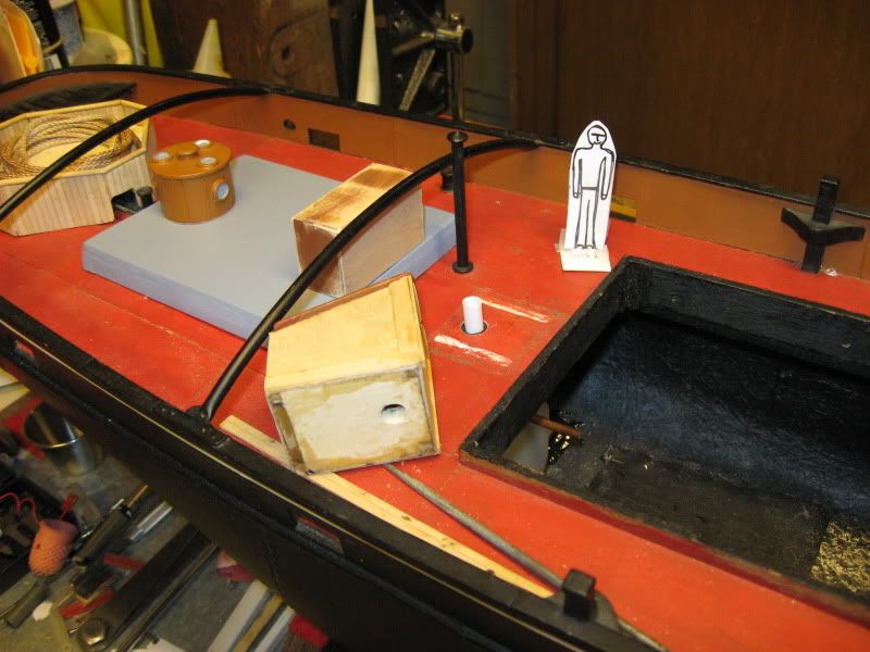

This is where I got to on the aft deck:
A auxiliary water tank ( with a fill port up through a pre-existing hole in the deck,
a rear sky light for the mate and captains quarters and a rear companionway ahead of the mystery locker
The companionway acts as a "cork" and is removable from the fill tube
The tank is removable as well and fitted with a vent tube , a suction line as well as the fill tube
I replaced the life boat that covered the rudder linkage with this:

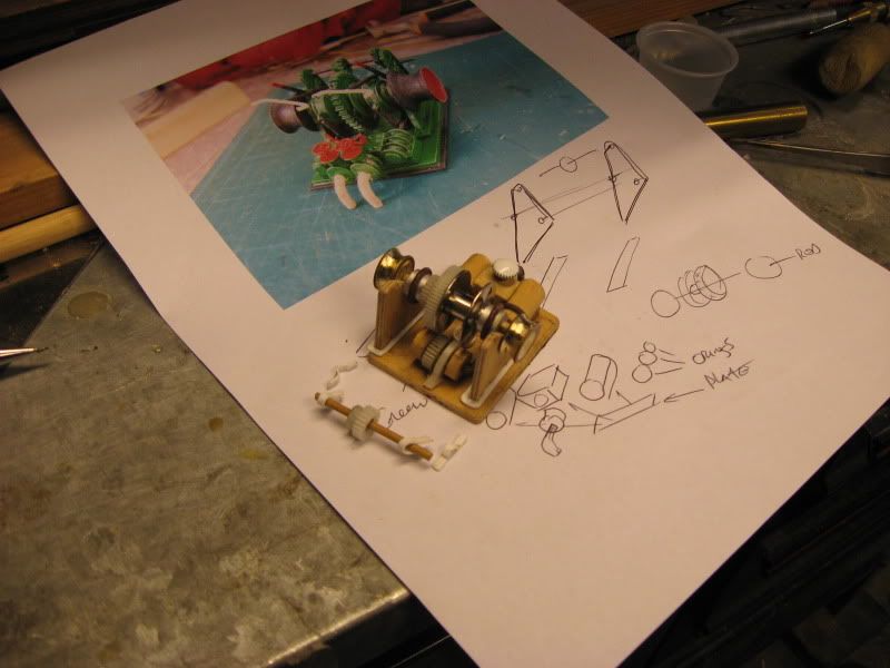

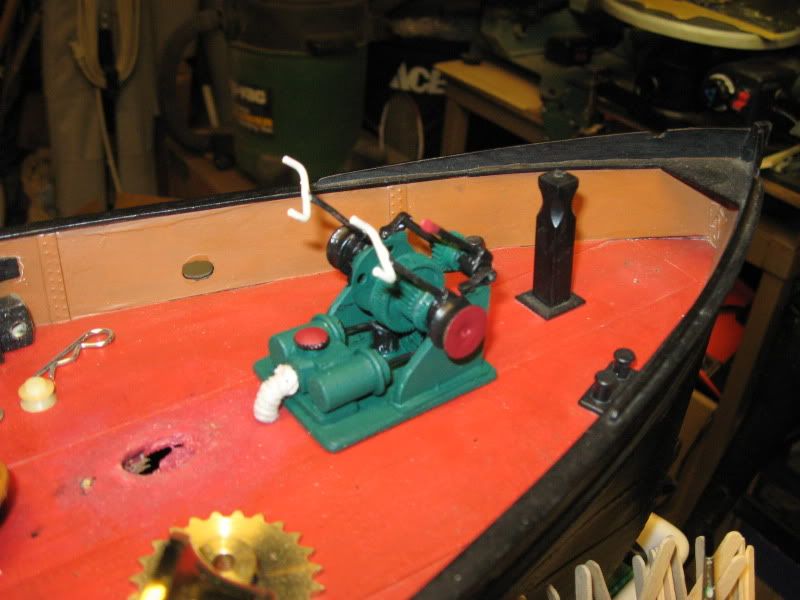

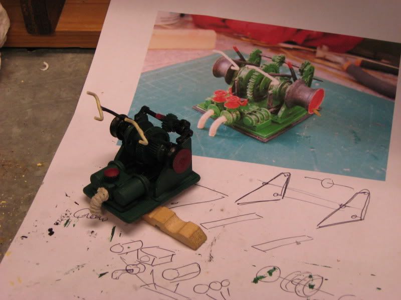

Lastly,  I built my own steam anchor winch...pictured is the one I copied.
 So here it is prior to gluing and painting
6 total hours and Glue+ 51 pieces and 4 colors later
I will be removing the Samson post
Fire away gentlemen  :whistle :whistle
