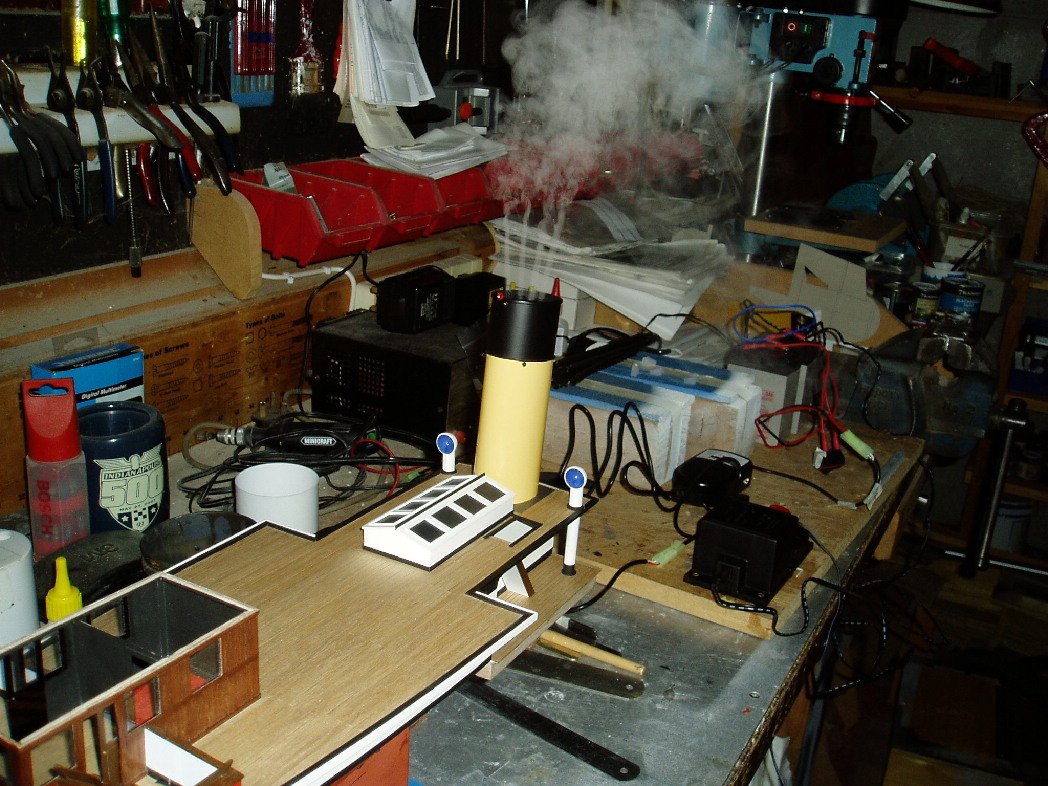

Took your advice Kim and made my own. Picture of bench-test in the gallery.
Used a Maplins mini-fogger, a computer fan and a voltage step unit to give 24vdc from 12vdc. Draws 1.1 amps. Tank is suspended from fwd superstructure. Re-filling is down the funnel!
Hi Pete.
I, also have been experimenting with the Maplins foggers. I've found the best voltage to operate it was 28volts DC. There was much more smoke than the 24 volts and it seems to run the oscillator quite happily.
