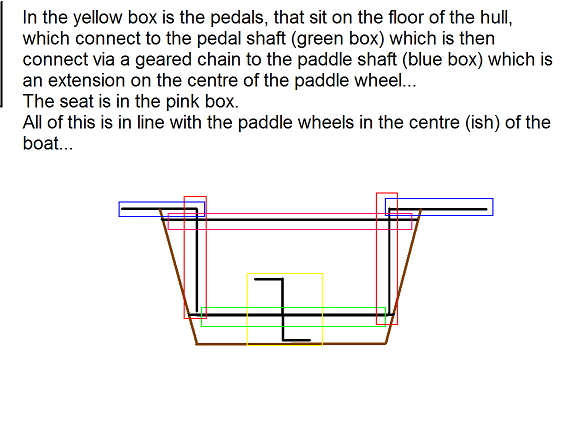

Also, I thought that it would be much better to have the paddles independantly driven, just to save having a paddle shaft that has to cross the width of the boat... which in turn would make it possible to have side wheels, because I could just detach the chain from the peddles and fold in the paddle box, and shaft would line up agains the wall of the hull..

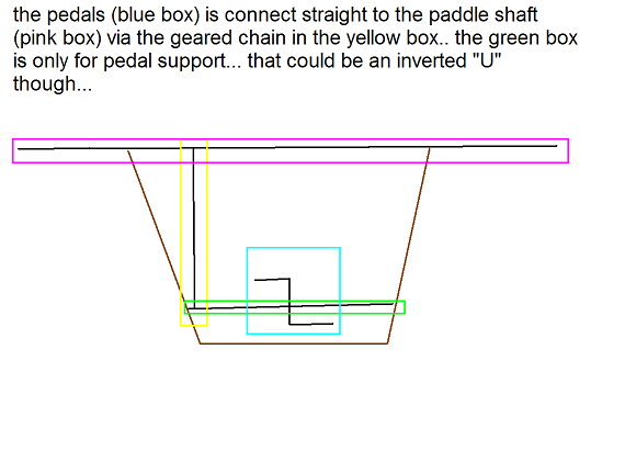

I also went and grabbed my bike and "RP7-ed" the pedals, gears and chain and worked out that it would be fine for the boat... 1 rotation of the pedals = 3.5 rotations of the back wheel... (is that 1:3.5 or 3.5:1)...
And if I were to have the pedals in the middle of the boat, in line with the paddles, I would run a shaft along the bottome with the pedals, that was connected to the paddle shaft via a geared chain..
Yes or No???
Or....
Do I just connect the pedals straight to the paddles via geared chains???
If anyone could point out the wrongs with this I would be very grateful...
Would love any help... Im not that great at mechanics...

I have still worked on having side paddles, with the pedals located on the floor attached to a beam length rod with 1 chain on either side that connects directly (but will be geared) to the paddles...

Yes, the auto canoes pedal/paddle set up is the basis I am working on, but will be a little different due to the difference in hull/where the peddler sits/etc....
But is along the same lines..
