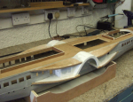

To continue on the paddle boxes, I've decided to re fit the wooden tops to them, as this will bring their height up to deck level. (111) (112)
I shall be fitting edging strips around them to improve their look. Also planned, is to fit a sealed cover under the inside edge to make airtight boxes around the wheels, so if she should heal over, it might help keep her afloat.  ;)

It was a nice warm day today, so it called for more painting. I have masked off, and sprayed the funnels. (113)  Also painted again were the lifeboats. These now have a coat of brown on the inside and the outside sprayed white, yet again. (it all adds to the smoothness of the finish)
Further work was done strengthening the paddle boxes. I have secured the lower fins (it’s what I call them) which taper to the hull from the curved sections, by fitting a small length of wood underneath to contact the hull, all epoxied in.
I noticed that there were three little portholes under this section already cut out, so I have re filled them with epoxy car filler. We don’t want windows below the water line now, do we?
The rear cover for the rudder was then covered in veneer to simulate wood planks. This is my first attempt at this caper so it’s good to start on something small. Good job I chose this as the learning curve is quite steep. So much can go wrong. Glue leakage going on the fingers and being transferred back to the veneer’s top surface.  Ugh!!!  No pictures yet.
I am now awaiting potholes and other things, so the building is paused until they arrive.
The parts built so far were then assembled on the model and taken out into the sun for some more movie clips to be made. These will be added together and edited for another ‘You tube’ build
Here are a few stills of the progress so far. (114) (115) (116)

Thank you for all your comments. I do agree with ones about the shaft location. This is indeed a little high, so the bearings were removed and the holes filled in. A new location hole was drilled, along with the matching one the other side. My little pocket Laser came in handy here. These were then fitted with a new set of bearings which were glued in to the new location. (117)
Here you can also see the wood sections that I’ve fitted, to strengthen up the paddle boxes. These are thin 3ply glued on to the existing plastic ones. I then fitted an edging strip from thin timber all the way around the edges to finish it off.
I had acquired 70, 6mm plastic portholes and laid them on a sheet of plastic. I then mixed up some clear epoxy and spoon fed a drop into each hole and left overnight. Two days later, the stuff had not set, so I set about scraping it back out and ruined them, so they are now in the bin. I like you idea about the brass ones, Sandy, so I might pursue this avenue.
While the glue was drying I made a stand assembly for her from thicker 3 ply and glued it all together and left clamped all night. The next day I cut up a mouse mat for the rubber strips and glued these on to the curves to hold the boat without scratching the paintwork.
The paddle boxes were sealed around the edges and sanded down smooth ready for painting.  The hull was also smoothed over and various bumps and gaps were filled and sanded down. (119) (120)
