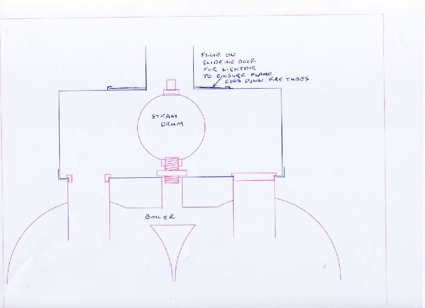

R.G.Y.
The drawings for the steam drum and manifold. Hope you approve Derek.  :beer
As for boiler inspectors, the trouble I have is finding one. They only like TRAINS.  :offtopic Geoff
G.Y.
steamboatmodel
Quote from: R.G.Y. on May 14, 2012, 10:01:22 PM
Mount some wheels on a platform and tell them its a logging train ;<)
Gerald.
Be wary of strong drink. It can make you shoot at tax collectors--and miss. Lazarus Long
R.G.Y.
#478
Good idea Gerald. :08 Just one word of warning never call a railway engine a TRAIN in ear shot of a railway man. They will never test for you.  :41 Geoff
G.Y.
