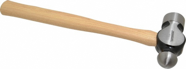

Author Topic: Building a river boat  (Read 97873 times)
Offline victor vector
  • Posts: 152
Re: Building a river boat
« Reply #60 on: August 29, 2015, 05:27:51 PM »
The pipes will be strapped below the deck beams , as a pair .
They will be suspended from a pair of 150 mm ( six inch ) C- Channels.
Offline DamienG
  • Posts: 1280
Re: Building a river boat
« Reply #61 on: August 29, 2015, 05:40:07 PM »
Coming along well.  :clap :clap :clap :clap
Offline victor vector
  • Posts: 152
Re: Building a river boat
« Reply #62 on: August 29, 2015, 06:10:48 PM »
Hi Damian ,
Are things as cold in Adelaide ?....I`m over winter myself .... :)
Offline DamienG
  • Posts: 1280
Re: Building a river boat
« Reply #63 on: August 29, 2015, 09:19:12 PM »
Well and truly over it our coldest night was -6.7c coldest in 20 odd years.
Offline victor vector
  • Posts: 152
Re: Building a river boat
« Reply #64 on: August 31, 2015, 12:58:18 PM »
Working out the pipe runs for the flush out.
50 mm ( Two Inch ) DWV  (Drainage , Waste , Vent )  Flush - out pipes.
300 mm DIA ( 12 inches )  x 7.6 m  ( 25 ft ) long x 2 .
Mirror image pairs. 1.1 Metric ton of Waste Water.
Extending the steel channel.
« Last Edit: September 02, 2015, 10:23:06 PM by victor vector »
wagnmkr
Re: Building a river boat
« Reply #65 on: August 31, 2015, 09:11:49 PM »
Just found this thread and I find it fascinating to say the least. That houseboat should last a very long time the way you have built it.
Cheers
Tom
Offline victor vector
  • Posts: 152
Re: Building a river boat
« Reply #66 on: August 31, 2015, 10:55:36 PM »
Hi Tom.
I`m trying to do the best job I can , given my limited resources and budget.
I intend to put down my tools after this project , apart from any normally  required maintenance , so long lasting would be good.
Thank you for the interest , and for stopping by.
Offline victor vector
  • Posts: 152
Re: Building a river boat
« Reply #67 on: September 04, 2015, 03:30:24 PM »
Bending up the straps for the waste water tanks.
Cold bent over a simple wooden former.
Final shaping done with a ball - pein hammer
Kill Rust primer on straps.
Mounting Bolts 12mm ( 1/2 Inch ) and washer .
Offline victor vector
  • Posts: 152
Re: Building a river boat
« Reply #68 on: September 05, 2015, 10:30:15 AM »
Checking straps for fit.
Good tight fit when the bolts are tightened up.
Straps will be spaced at 1200mm ctrs. or 4 ft.
« Last Edit: September 05, 2015, 06:15:33 PM by victor vector »
Offline victor vector
  • Posts: 152
Re: Building a river boat
« Reply #69 on: September 13, 2015, 04:04:38 PM »
Bridge deck tunnel planking above the tanks is now in place.
Left hand C- channel bolts are not yet tightened , so it looks like there is a gap above the channel.
Bolting up the 150 mm ( 6 inch ) C - Channel.
Tunnel planking plywood edge.
Tunnel planking battens will run along this edge.
Tunnel planking joints are backed with a strip of marine plywood .
I will back out the coach bolts at this beam location , and apply a bead of sealer under the plywood.
C Channel in place.
Definitely a two person job.
I worked alone .It was difficult ,  hard work.
Hardwood tunnel battens fixed in place.
Port side tunnel structure is ready to fit plywood.
« Last Edit: September 15, 2015, 07:20:45 AM by victor vector »
Offline herrmill
  • Posts: 129
Re: Building a river boat
« Reply #70 on: September 15, 2015, 09:58:26 PM »
Very nice craftsmanship!  It wouldn't be too hard to hang a paddlewheel off that stern.  ;)
"China is a sleeping giant. Let her sleep, for when she wakes she will shake the world." ~ Napoleon Bonaparte
Offline DamienG
  • Posts: 1280
Re: Building a river boat
« Reply #71 on: September 15, 2015, 10:43:20 PM »
Indeed
Offline victor vector
  • Posts: 152
Re: Building a river boat
« Reply #72 on: September 16, 2015, 07:11:56 AM »
Very nice craftsmanship!  It wouldn't be too hard to hang a paddlewheel off that stern.  ;)
Thank you for the kind words herrmill .
As much as I would like to , I do not feel that I have the expertise , ability or resources to successfully  fabricate and fit a paddle wheel to this little boat.
Ideally , I would like to see twin hydraulic motors and a small diesel driving a paddle wheel , but presently ,  it seems beyond my means.
And thank you too for still watching , Damian !
Offline DamienG
  • Posts: 1280
Re: Building a river boat
« Reply #73 on: September 16, 2015, 02:18:56 PM »
I'm thoroughly enjoying this build mate great innovation involved.
 :bravo :clap :bravo :clap
Offline victor vector
  • Posts: 152
Re: Building a river boat
« Reply #74 on: September 17, 2015, 01:47:08 PM »
Look honey , there is a hole in the floor!
This opening will give access to the top of the tanks to connect the 50 mm ( two inch ) vent pipes .
One vent to each tank.
Starboard side vent pipe coming up through the rear deck.
50mm hole cut with hole saw and slightly enlarged with pliers.
I am still waiting on the rubber boot / seal , it will be fitted at the base of the vent.
Mandatory bug screen fitted to the vent stack.
Pipe is painted black to aid convection.
Back to work for me.......
« Last Edit: September 17, 2015, 02:13:55 PM by victor vector »
