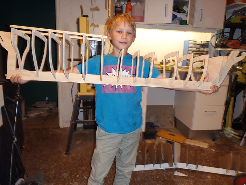

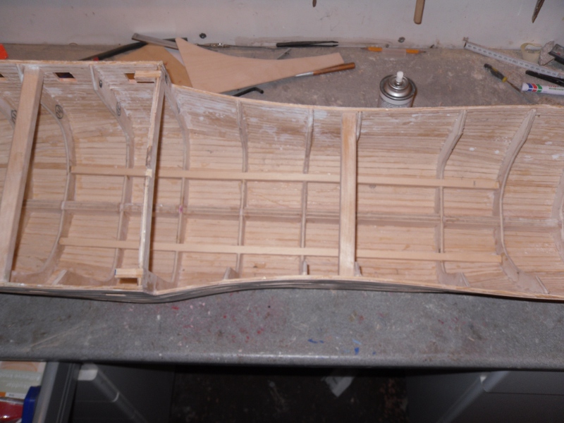

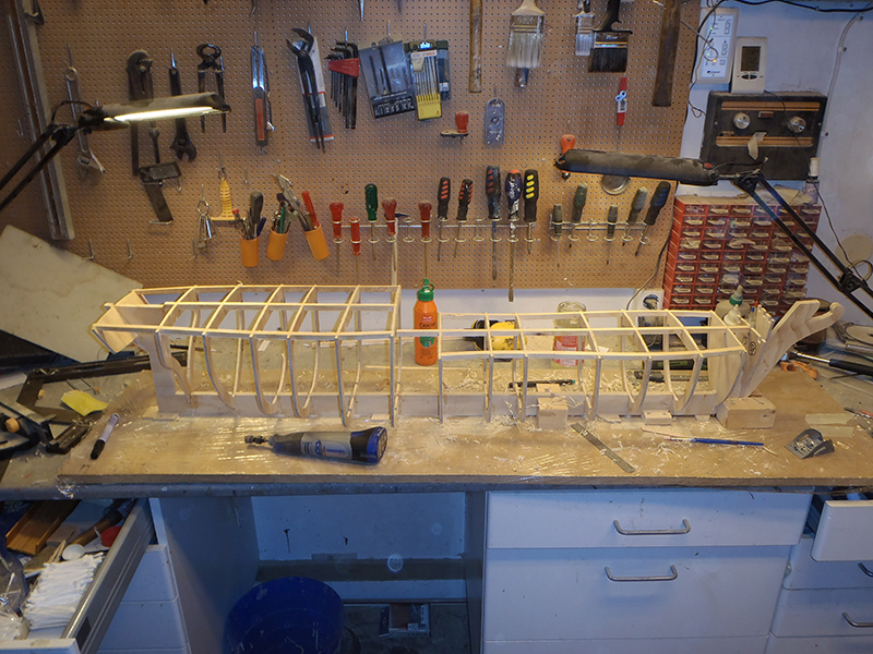

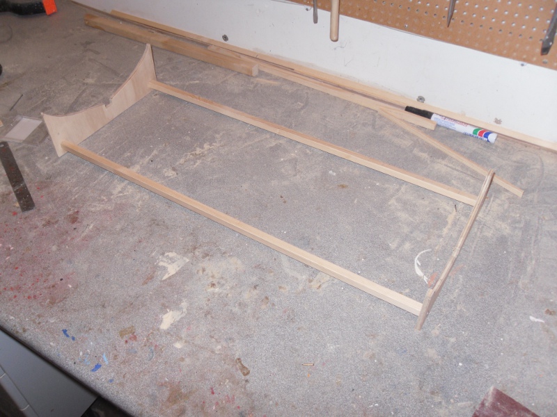

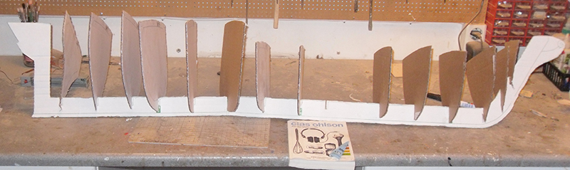

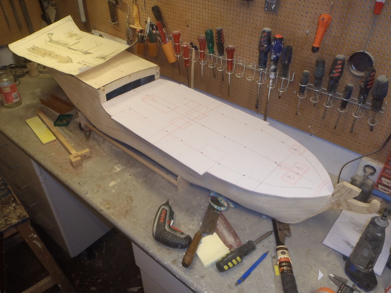

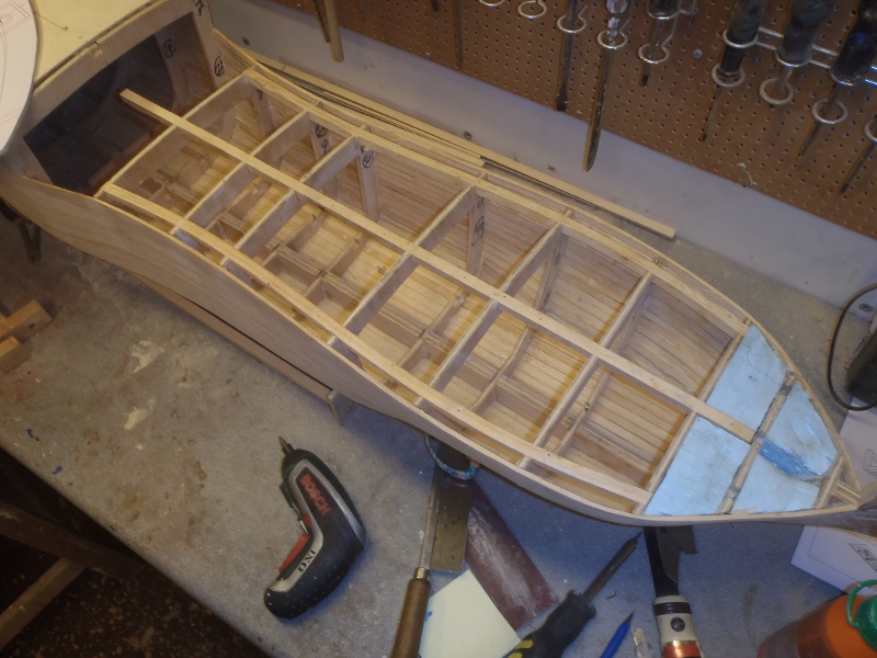

I started my build with a cardboard mock-up to check that I have got the frames correct. Found a few minor problems that easily were corrected.
Some of the cut outs for the frames had to be done manually as my band saw was too small
My 8 year old son holds up the dry-fitted keel and frames. Model is longer than him :o

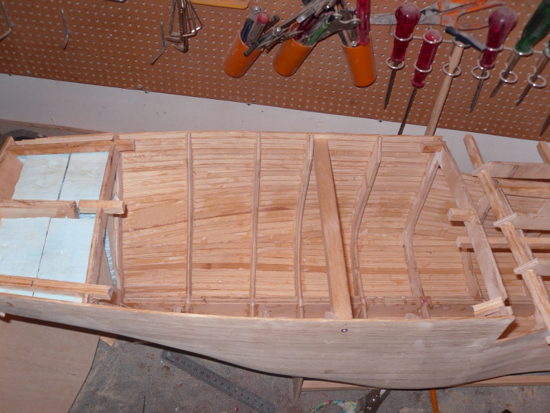

Frames and deck beams glued. Deck beams made from three thinner planks glued together to avoid a heavy steaming job. All gluing with Polyurethane, dries rapidly in the damp conditions we have due to heavy rain at the moment.
Hull has very interesting shape due the fiddle shape. Think there will be some challenges when planking

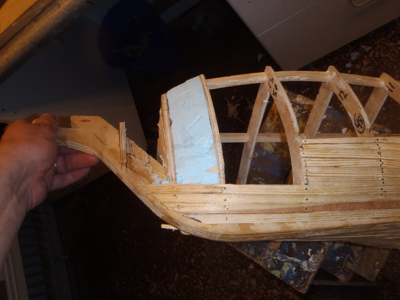

Tonight frame sides are sanded and filler blocks mounted in the front. Tries blue foam blocks for filler blocks instead of balsa this time. Have some pieces of blue foam left over, seems to be as easy as balsa to shape but cheaper. Photos in next update

Slowly the hull gets shaped. Blue foam works excellent as filler blocks but sanding smells like BBQ grandma’s knickers. Started planking from keel, maybe it should have been better to start from top. Hull shape is a real nightmare it curves in all directions at the same time. Not really happy with the look of the planking but I’m doing my very best.

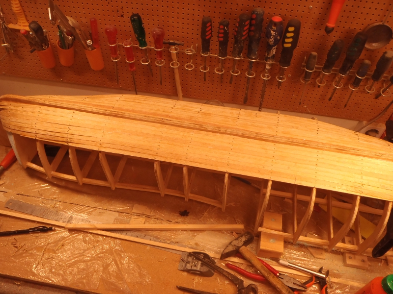

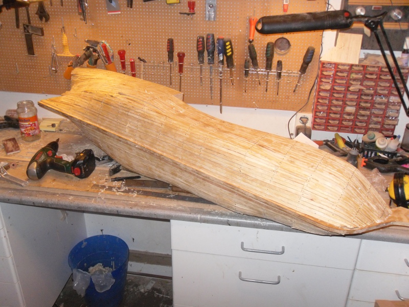

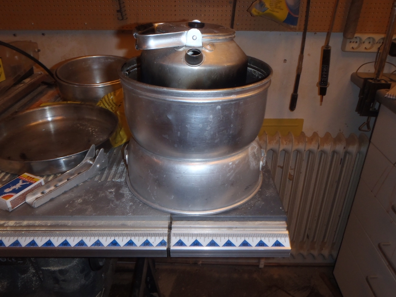

To steam the planks I use a camping coffe pan. Works fine, but I burnt my fingers several times.

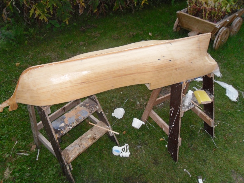

This Friday the planking was finalized, looks quite bad but sanding and some filler will for sure make it look nicer.

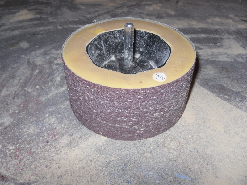

Sanding was a tough job, pine is really hard to sand by hand. Tried several power tools until I found that a big sanding cylinder in the cordless drill was the right tool. Some hours of sanding gave me this result
Two tubes of filler and a lot of sanding finally gave an acceptable result.

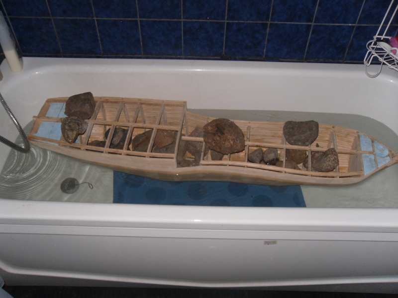

A quick test in my model boat test tank (my wife insist of naming it “bathtube”) verified that my calculation of a displacement of 21,7 kg was not that bad. In the test I added 20 kg of garden stones and waterline was approximately in the correct position, a little high but the weight of frames and planks is 3,7 kg. Next step will be to start with the decks and then the second planking.

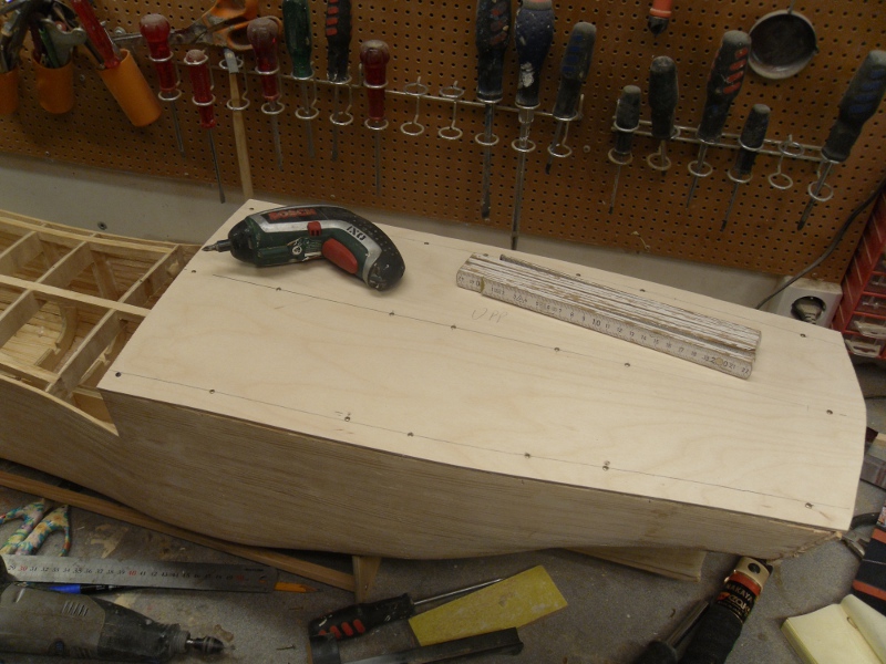

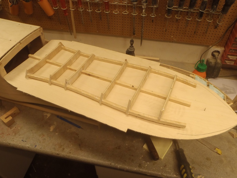

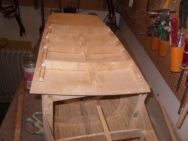

The rear deck has to be removable to access R/C equipment. I have spent some weeks thinking of how to hide the screws but finally I found out that the bollards could be mounted with magnets and hid some screws. Other screws could be hidden in the deckhouse that could get a removable roof. Prior to mounting rear deck it looks like this.
The deck is made of 3 mm plywood and screwed to the deck beams. I quite rarely use my full size screw gun when building model ships
The deck is unscrewed and the deck beams cut with my razor saw. A piece of 15*15 mm birch timber is mounted for hull strength and shape.
The free part of deck beams is glued to the deck and the screws are carefully matched into the old holes. Scratch building is like flying to the moon while building the rocket during the trip. One can think of a problem for several weeks and suddenly the solution is found. I feel quite confident with the final solution.

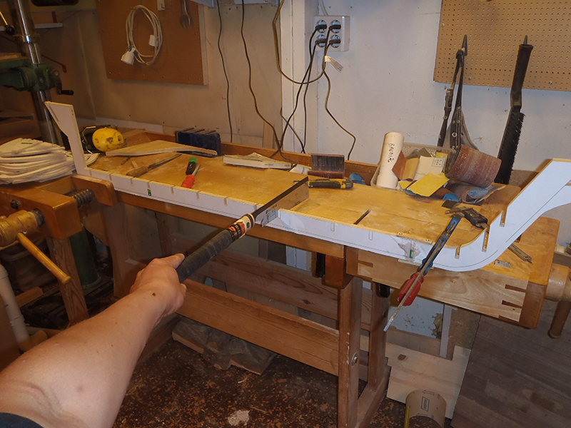

The front deck is a bit tricky it is wider than the hull and not easy go get into shape. I spent one full night with the CAD to make the drawing, got some scaling problems that took time to work around. But finally I managed and could print four A3 sheets that were spray glued to plywood and sawn.
Deck beam assembly will be cut out as for rear deck.
Deck beam assembly screwed to deck, not glued yet as I will need to remove deck for final trimming.

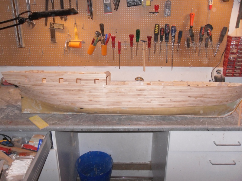

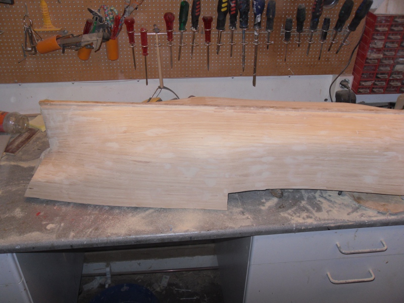

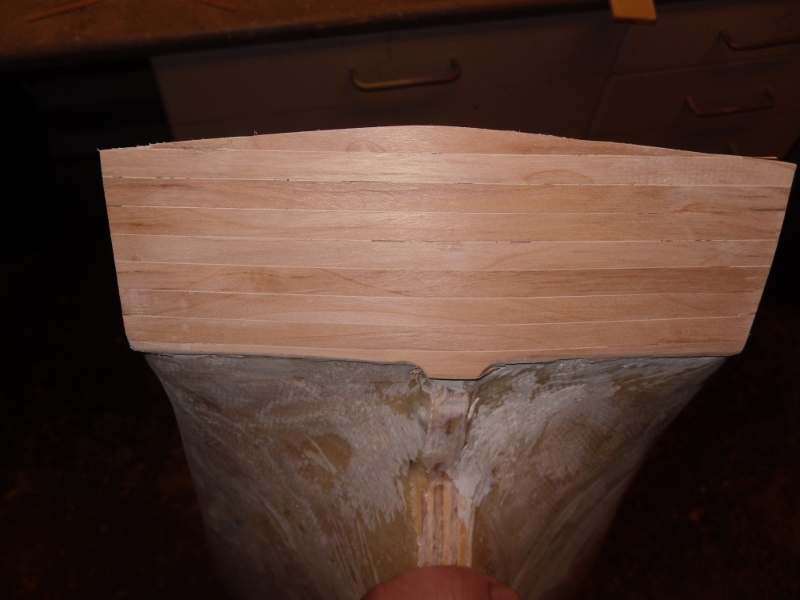

Second planking started at the rear end. The maple from my garden gives a really nice appearance. Just a shame that it will all be painted black
Second planking of hull sides is almost done. Hull bottom will be covered with cupper sheets. Hull shape is really tricky. Will need some filler also for the second planking.

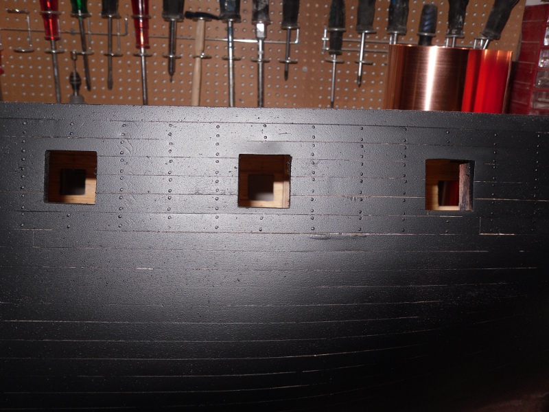

The rear part of the hull has visible nails above waterline. I purchased some 0,5*10 mm nails from Cornwall models boats and spent one night of putting 200 of these into the hull. One does not have to be crazy to build model ships but it surely helps ;)

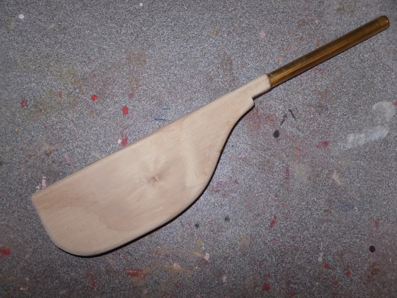

The rudder was built from 10 mm plywood and a brass tube. Not as easy at it ooks. The two first rudders were moved inot the wastebin, but the third one got acceptable. The rudder will be using a 10 mm brass tube for bearing, some grease between the tubes will give a smooth and water tight mounting.

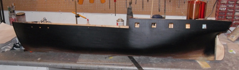

Hull painted black with spray.
A closer look

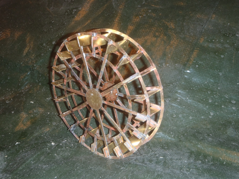

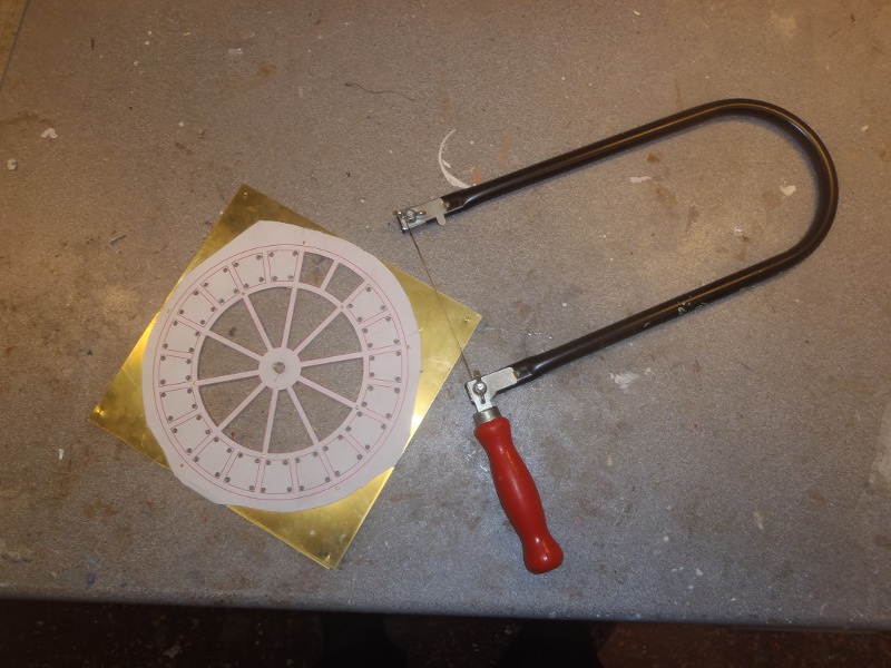

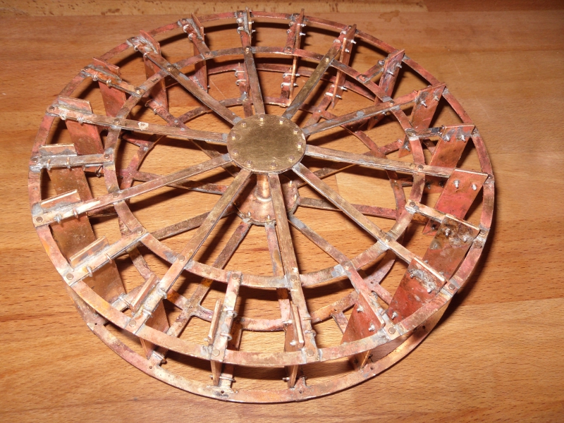

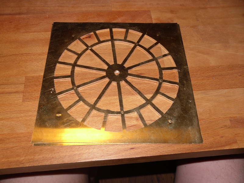

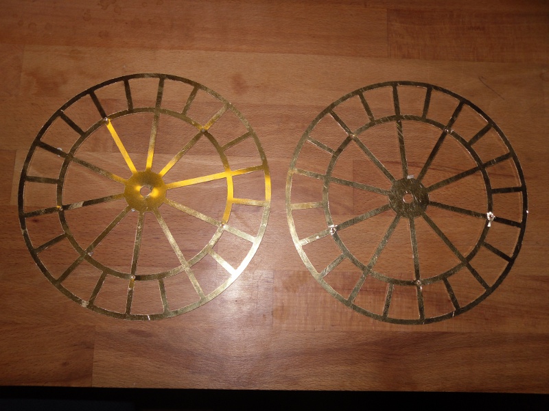

Now it is time to start making the paddle wheels. Sides will be cut from 0,7 mm brass sheet metal. I start with some CAD work to get a drawing that is spray glued to brass sheet. To get the sides exactly in the same shape I took two sheets of brass end riveted them together with some fine brass nails. Then some drilling (121 holes) and then hard work with a fret saw.
After filing and separation I have two sides.

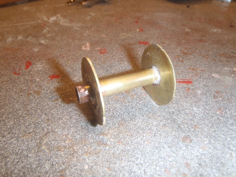

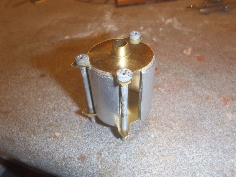

Without access to a lathe I have to braze the hubs, Had big problems and ruined my paddle wheel sides until I realized how to make a simple fixture. I left some “ears” of the hub sides and drilled them 3 mm. Cut a piece of aluminum tube to 30 mm and cut to C-shape.
Assembled I got this nice “packet”, just to braze.
Removing screws and Al-tube and “ears” offcut gave me this result.
As paddle wheel sides were ruined it was just to do some more fret sawing.
As I got some severe pain in my arm from the sawing I continued with some other work. Dry fitting for ball bearings. They are really tiny, just 10 mm in OD. See the match as reference
Axis cut to rough length, seldom a full size angle grinder is used in modelling

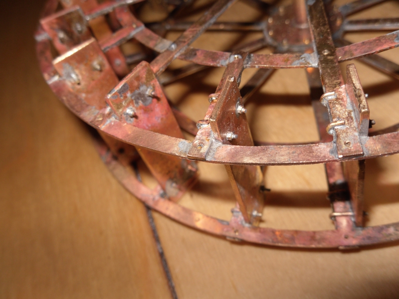

In full size the oak floats are secured with iron clamps that are treaded at back side of float and mounted with nut, this will not be strong enough in 1:20

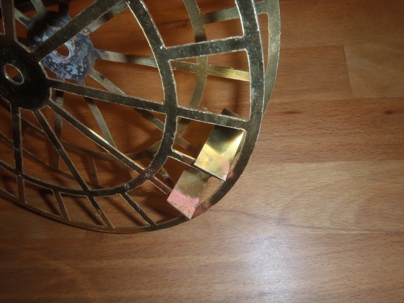

I decided to go for floats in 1,5 mm brass (Could one call floats made of brass for floats or will they become sinks?)and solder them to sides. Made some tests with the ruined sides and some pieces of scrap brass, looks promising. I had to order a 200*500 mm sheet of 1,5 mm brass,  just £70. >:(

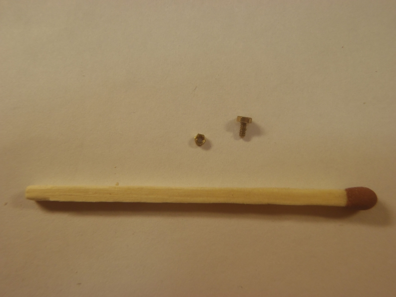

I found some nice M1 brass screws and nuts at RB model in Poland. Ordered a sufficient number of them to use on my paddle wheels.

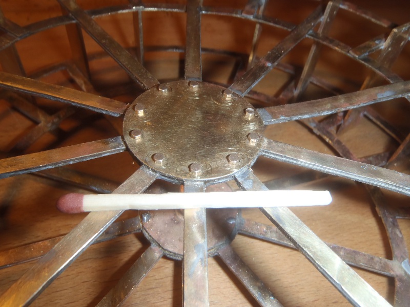

Finally the soldering job on the first paddle wheel was finalized
Some screws did really add some nice details to the hub of the wheel, mounting was a bit tricky.
The hooks that hold the floats are made from brass wire and a M1 nut is soldered, I do not think one will see that the treads are missing on the hook end
Finally the first wheel is complete at one side.

1. that is a brilliantly constructed & beautifully scaled wheel set..........
2. are you going to age the brass naturally or use a chemical agent?........it would be a shame to paint the wheels & loose the clarity or crispness of detail
3. I think these are the most professionally home constructed wheels I have seen  :bravo

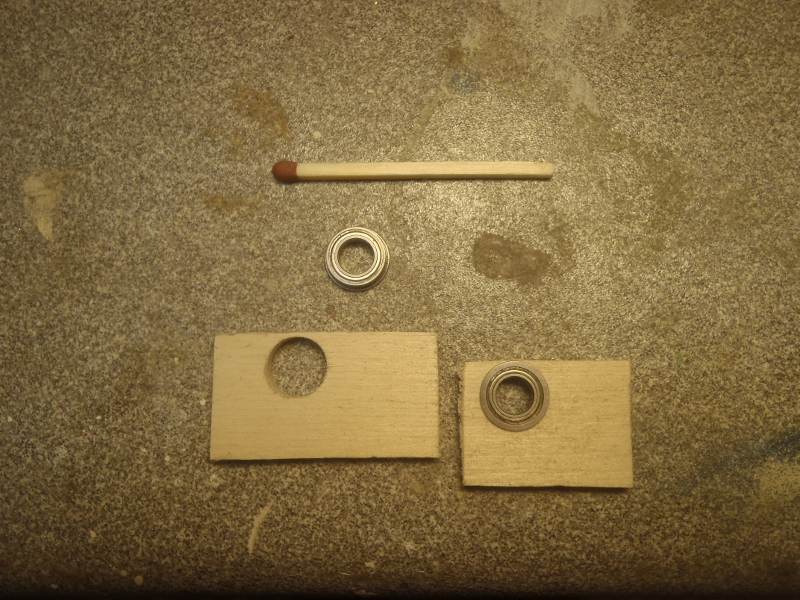

5. the ball bearings.....I see they are flanged....are the ZZ [sealed both sides]?
6. if the ball bearings are 10mm OD, is the shaft 5mm?
7. if the rudder profile is to scale........you may experience poor steering........many models require over scale length or surface area to achieve steerage
