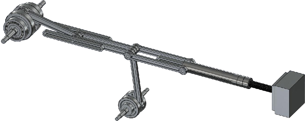

Hi,
I've made a few thoughts on how to design a kinematically satisfying electric sternwheel drive via pitman arms.
My criteria were prototypical motion of the visible part of the pitman arms, simple and compact construction, and, if possible, homokinetic transmission. The latter means: The rotation of the drive shaft should be transferred 1:1 to the wheel shaft without cyclic variations in ratio, speed or torque oscillations, and as little play or backlash as possible, because play in links which act alternatingly pushing and pulling might cause jerks, noise and wear.
A few sketches of a handful of variants, some of which are well known, and some of which I haven't seen in reality yet, are attached.
I would highly appreciate any comments, additions or experiences out of the praxis.
Is anyone aware of any other (satisfying) concepts?
Regards, Moritz

Quote from: "mjt60a"
Many many years ago, I tried to make a mechanism that would operate a sternwheel in a realistic way (...) ...anyhow, similar to variation 5 but with the motor shaft even further forward..... :?
No, that's a perfect example of variant 2 (sorry, I didn't find a more logic classification).
The slight disadvantage I see of such arrangement with two mirrored crank drives facing each other, acting in opposite directions, is that the irregularities of the visible outer and the hidden inner crank drive ADD to each other.
I would guess that, if your mechanism did't stick, this was due to some play in the various joints and especially some elasticity, presumably due to the extremely short guided length of the slider.
Variant 5 is somehow different: The inner and the outer crank drive (preferrably with equal rod length) are both oriented in the same direction, so that the irregularities CANCEL each other instead of ADDING.
I would therefore guess that variant 5 should run much better, but I haven't tried it in hardware so far. We will see...
Regards, Moritz

Sometimes you don't find the easiest solution in the first place...
The Variant 4 (Scotch Yoke type) seems to be quite popular and has repeatedly been built, but has the disadvantage of being non-komokinetic (with the jerking and/or jamming problem described above).
But why not turning it into a perfect homokinetic drive by making a curved slot or groove in which the motor crank pin runs? To make it clear, I've added one more sketch (I've called it Variant 4 1/2 because it combines the advantages of Var. 4 and 5).
In this way, the length disturbances of the tilting pitman can be fully compensated.
But I've never seen it built so far. Why???
Because the curved groove is more difficult to make? Because nobody else has thought of it so far?
Offline Bierjunge

Almost five (sic) years later...
I've drawn a few free-hand sketches of how the Versions 5 and 6, favoured by me, might be realised:

Hi Moritz,
It's hard to believe this thread has popped up from so long ago. As regarding the curved link it would not be hard to make, for me, as I have a milling machine and rotary table for my hobbies. I make links like this for steam engine reverse mechanisms. The only problem would be if the link slot was not a constant radius. It would have to be plotted out to see what was needed.
gbritnell

« Reply #10 on: May 24, 2012, 01:27:37 AM »
Way back when I did several layouts with my Autocad drawing program to see if I could come up with a viable intermediate link system for driving the paddlewheel. In regard to your drawings the first one would work only if the rod from the bellcrank was the same length as the rod from the crosshead to the wheel otherwise you would get some angular differences in the motion. As far as you curved link assembly I'm not sure how it would work without doing a mathematical layout.
gbritnell

Hi Moritz,
I used two scotch yokes and , yes, there had to be some slop to prevent it from jamming but it seems to run smoothly and the sound seems similar to the popping of the steam engines.  But I really like your last two drawings.  with the curved slot.  Before I retired I worked with Solid Works.  I could draw all the pieces and put them together and rotate the shafts to check for jamming and smoothness operation.  That's what is needed here.  I wish I had Solid Works now.
Bob

« Reply #14 on: February 21, 2016, 11:37:01 PM »
In Addition to the homokinetic solutions in the original posting and reply #6, here's even one more:
Moritz
