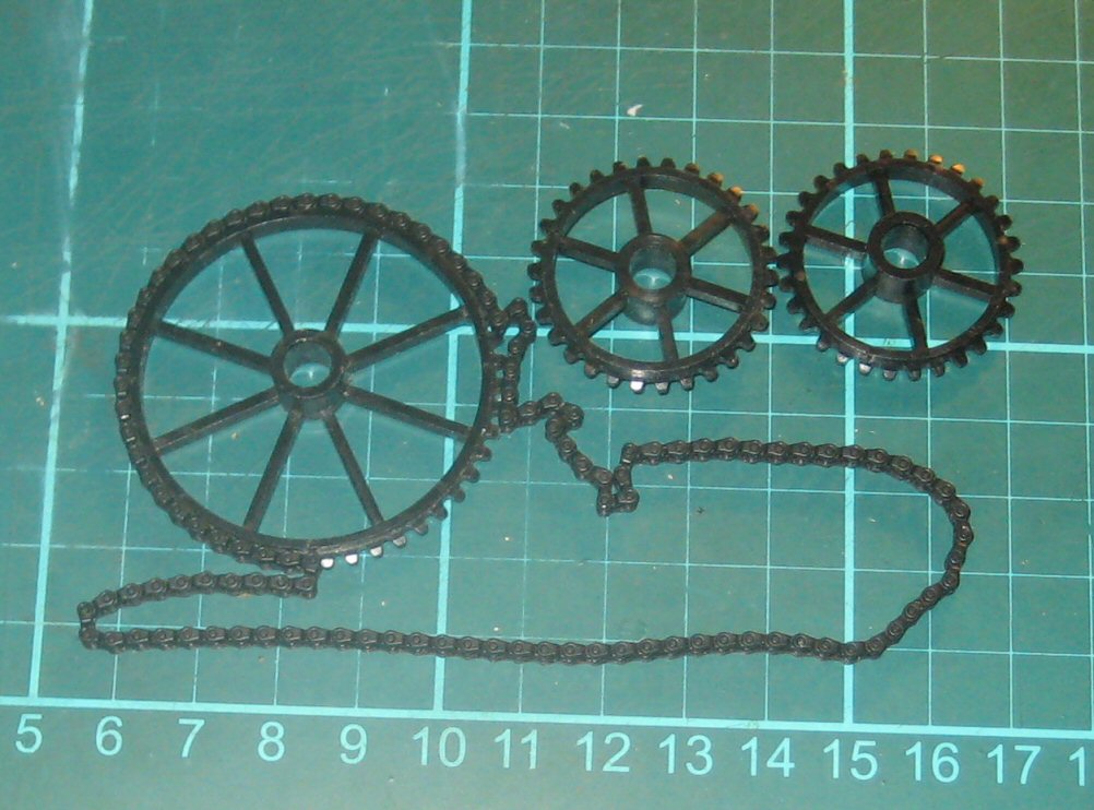

« Reply #19 on: December 28, 2009, 04:04:44 AM »
Hi Phillip
Before you get to wrapped up in whether the chain is EXACTLY to scale consider this; If you construct a model to EXACT scale it will look somehow 'wrong'. A good example is model cars - you know the sort of Burano quality diecast things. If you measure for instance the size of a door piller it will be about twice the thickness it should be. This is not because of manufacturing limitations, it is because if the pillers were the 'right' size our brains simply will not accept that they are capable of holding up the roof of the car - this is known as 'scale effect'.
As Derek rightly says the chain I've suggested is slightly overscale - but it may very well look right on the model.
Anyway here's a picture of some components laid out on a centimetre grid to give you an idea,
All the best
Stuart

« Reply #20 on: December 28, 2009, 05:59:52 AM »
Hi Stuart,
Your chain and sprocket picture are worth a thousand words. I'm not looking for an exact replica. My cad drawing was 16' breadth and my model is 17' 1/4". Slightly larger, but I can live with it.
I'll be placing an order Monday morning.
