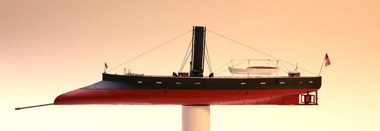

Just stumbled across this topic while looking for info on feathering wheels and thought I'd add my two bits for the record...
The Fowler wheel did indeed provide great maneuverability, the Alarm was able to turn in 1.5 lenghts. However, it failed to provide speed, which is rather crucial in a torpedo boat. After lingering for some years, the Alarm underwent a substantial overhaul, which included replacing the Fowler wheel with a Mallory steering screw. This contraption looked and worked much like one of those swiveling fans you encounter in hot climes. It preserved the ship's maneuverability, but didn't add any speed. The Alarm lingered some more and was eventually sold for scrap in 1898. Here's my 1/250 scale model of her:
Cheers,
Oliver
Red_Hamish
Re: Fully submersed paddlewheel?
« Reply #3 on: January 31, 2009, 07:10:57 AM »
Well Oliver what can one say. What a fantastic model
