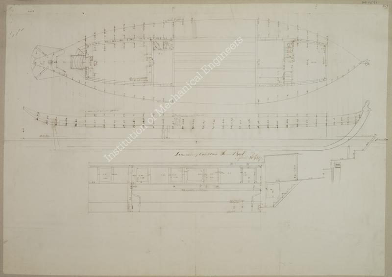

Re: Caledonia (1817) Boulton & Watt
« Reply #19 on: October 07, 2012, 01:37:40 PM »
Holder, if you look more at the picture gallery, there are about 8 other engineering drawings of the caledonia.
rheintrutz
« Reply #20 on: October 09, 2012, 05:46:01 AM »
@ Eddy
Thank you for the praise and acclaim of our Modells.
It was natural to share the Modell - especially with the Paddleducks - because all their helpful hints.
@greateastern
Yes, i know them. There are a total of 10 drawings of the Caledonia on Imeche.
They was very helpful for the contruction.
