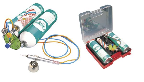

sunworksco
Re: Metal Hull Making
« Reply #5 on: November 21, 2010, 03:42:17 PM »
It is much easier to build with 316L stainless-steel  sheet. It is very malleable, soft/hard solders easly and silver solder matches the s-s color. It solders very well to copper or 260 brass metals. I use silver soldering paste that comes in a syringe, making clean-up a breeze. I use 316L s-s where the marine vessel is prone to abuse because the 316L s-s is more durable. It has 10 times more tinsel strength than copper or 260 brass, so it can be lighter gauge than tin or brass sheet. You can also glass bead-blast the s-s surface after soldering to give a satin finish for chemical-staining a colored finish.
I just bought a brilliant torch set-up for hard silver soldering with the accuracy of a laser.
It is made by MiniFlam and uses non-hazardous highly filtered oxygen and propane/butane bottles.
The bottles are not banned from normal parcel shipping or use in public spaces. They can be permissively operated at show exhibits.
The torch tip and handle are small and pencil-like with the mixing valves located at the bottles, so no obstructions when using the torch.
I'm building a USS Holland submarine and also my avatar in 260 brass/316L stainless-steel sheet.
