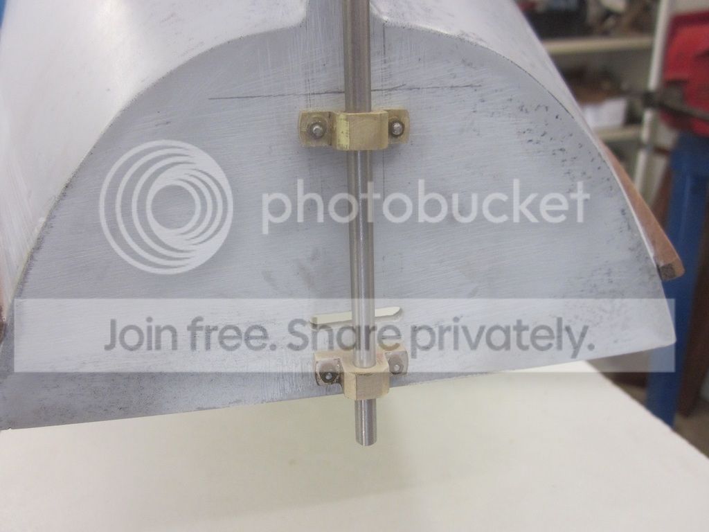

Progress has been made, the ribs are finished finally, each one took around an hour as they are all a bit different from each other. I am now working on the rudder supports prior to painting the outside.
The screws on the rudder shoe are temporary until I get the correct ones

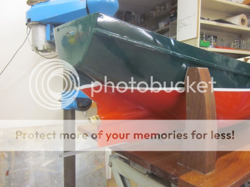

The hull is finally painted. The red is a little too red but the colour swatch showed it more like the old Red Lead paint colour. However when it is in the water not too much red will be visible. Next step is fitting out of the deck. I am undecided between Teak or Tasmanian Oak.
Robert

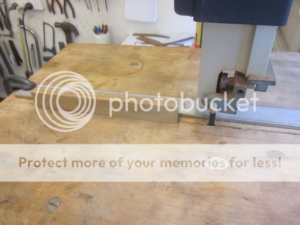

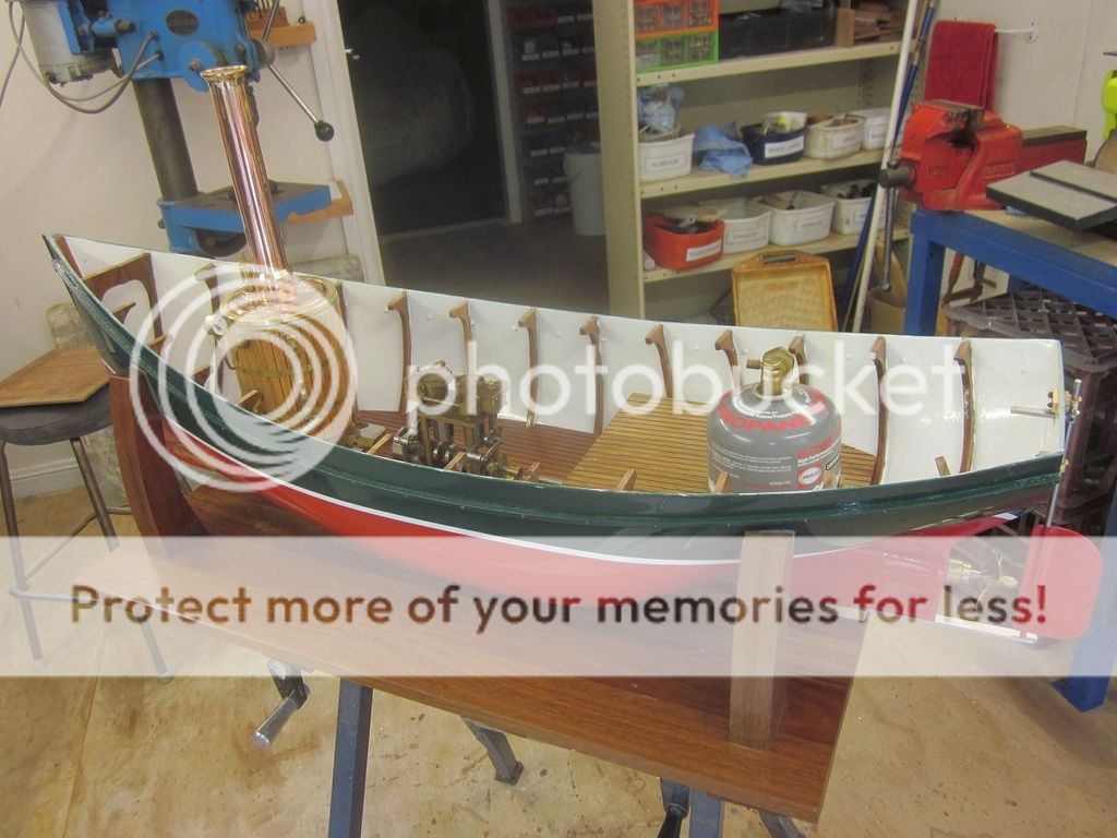

Progress has been made and I have commenced work on the decking. I had planed to use Teak but after locating some decided it was too dark for my liking, so I will be using the much lighted Tasmanian Oak.
With the hull the correct way up and the power plant fitted it is beginning to look like more like the real thing.

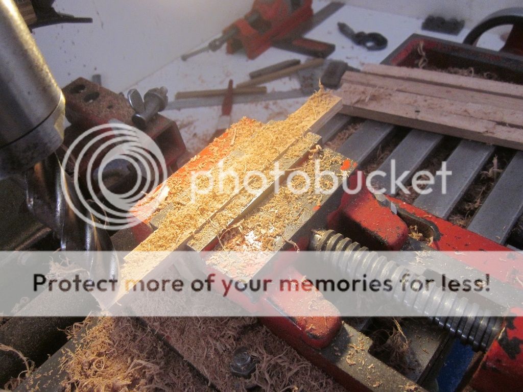

Cutting the Oak int 8mm strips.
Milling the strips down to 6.4mm
And gluing together for the fore deck.
I trial fore deck from scrap timber to sus out the making process.

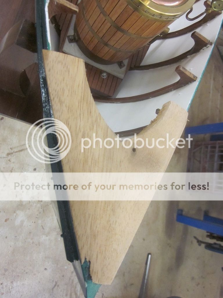

Many moons have passed since I have added to this post as other things about me have taken precedence. The edge decking is taking shape finally and only a couple more sections to add then I can commence on the cabin.

Gluing the Side trim to the deck. On another website I had some help in figuring out how to clamp the remaining 150mm. I need to make a special curved strip of wood with notches to allow clamping.
Robert
